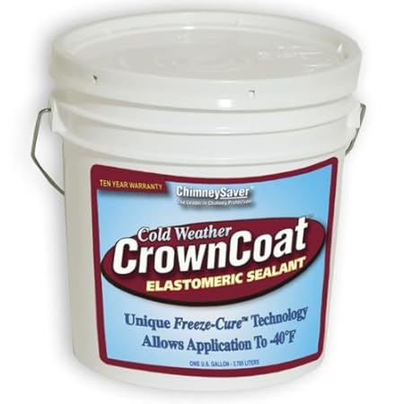

    2. the mortar that is domed at the top of the chimney has very small cracks and needs to be coated with his special coating warranted for 15 years at a cost of 700.00 +

    Unless you have a HUGE chimney, $700 is a lot of $ for a crown coat! Most chimney crown coats run about $350 or so in this area. Don't worry about any bricks in the firebox, they are to contain a fire, you are adding a new upgraded firebox, called an insert. As for the gap between the firebox and the brick face, you can stuff it with insulation and then morter over it if you want, but with the insert and the liner going in there is no real reason to. You shouldn't have to pay for a level 2 inspection anyway, in order to do a level 1 inspection and a cleaning all of these areas would need to be accessed and inspected anyway. In this area the charge would be between$130-$150.
