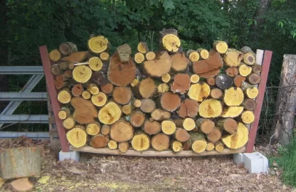

    Yeah, I was so psyched on that scrounge I filled all the space under the camper shell in case I never got to go back for the rest of it. A few days later I checked the weight and thought, whoa! If this isn't 1/2 cord, I apologize. But there's a round or two that were too big to lift onto that rack.

    I'm gonna rain on your parade a bit. The stack looks like about 1/3 cord to me and, even though you may have added the helper springs, your lite duty truck is still over loaded. The breaks, tires, wheel bearings, drivetrain, and transmission are gonna suffer if you keep it up. Helper springs do not increase the GVWR.

    No rain at all. I completely agree that the helper springs don't make the axles or tires stronger. And working things harder does shorten lifespan. I went to the CAT scales and got 4,020 pounds unloaded. Went back with my normal band equipment load and trailer, and got 5,960. My normal workload is less than the 7,400 GVWR.
    Did I exceed 900 load limit? Probably.

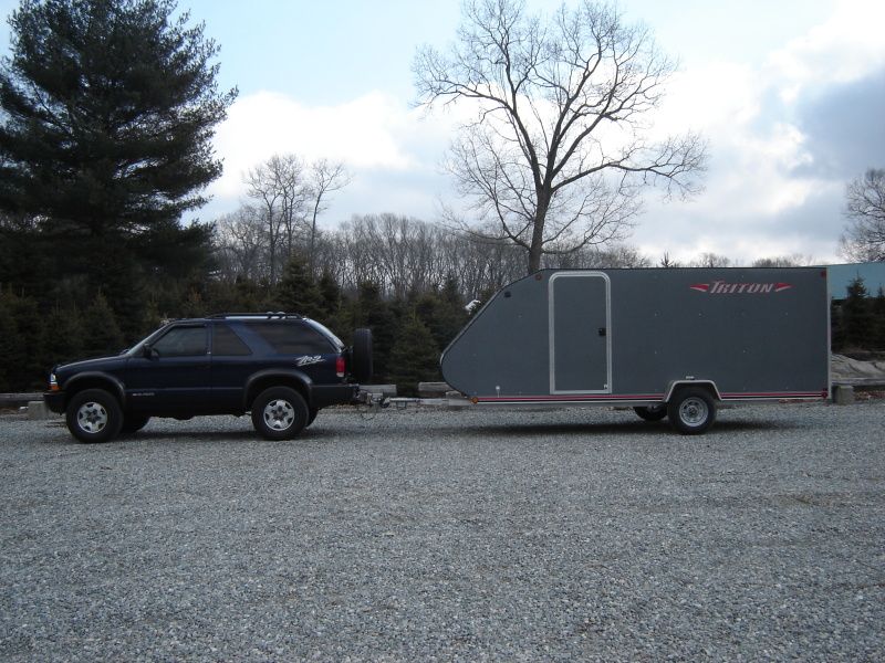

    Pics of Air Lift brand air springs installed on my 2 door '03 Blazer ZR2.
    http://s23.photobucket.com/user/Mustash29/library/#/user/Mustash29/library/Air%20Lift?sort=3&page=1&_suid=137700142643708530817782652413
    This is actually a kit designed for a non-ZR2, the bags should be taller for my application. I don't take it off road and flex the crap of of it so I just made two 3/4" spacer discs out of UHMW for each side.
    Capable of 5 - 100 psi and it will ride level no matter what. I've had nearly 1000 lbs of vacation cargo, food, drinks, etc in the back + 350 tongue weight from the sled trailer and it simply rides awesome.
