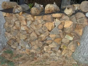

    My wife split this hemlock and I stacked in April 2012. I told her it was okay to leave the splits a little large because it burns relatevly fast and the larger splits will give you a longer burn time. Well...when I got home from work this is was the result.
    How long does this take this to season? Should I hold out the really larger splits I should hold out for 2 years? Will the smaller ones be ready for 13/14? I am assuming this stuff seasons in one year. (bad thinking?)
    About a cord and a half total, face stacked.
    New wood to me...I am used to white pine.
    Thanks,
    Bruce

    I would give it a full year, especially if it was green when you cut it. I burned some that was 7 months seasoned (hot summer) it was ok but will give it a full year in the future.

    A full year minimum for any green wood is a good idea.
    Of course when it was fell, & water content when CSS have an effect.
    You may get by with less time since hemlock dries pretty fast. If needed, I'd burn it.
    It's had all summer to dry, It's better than what many folks are burning ;)
    Don't think you can improve the burn times much with lower BTU hemlock. A good shoulder season wood for your area.

    I should mention I cut this down green in January 2012 and left in rounds 16" long until it was split. I will not touch this at a minimum until fall of 2013 if it is dry < 20% moisture content. I have never seasoned or burned hemlock before.

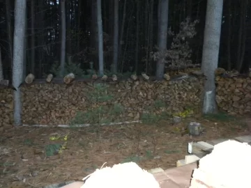

    I will not need it. I have lots of standing dead pine for the shoulder seasons, but will filter the hemlock in to the schedule if it is ready next fall. (hemlock, better burn times than white pine)
    My red oak and sugar maple turned 1 year old last month. The oak will sit another year at least, but the sugar may be ready next fall/winter. I will check it next January with the meter. 1 cord each.
    I have another cord of hard maple, white oak and red oak mixed for 13/14.
    O- also at least 6 cord from the grapple load being processed now. (almost done splitting)
    About 4 cord of pine logs to process in the late winter.
    Still thinking ahead too.
