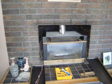

What's it (the fireplace) made of? And what's behind it? If it's an all-masonry fireplace/chimney structure with nothing but non-combustibles from the fireplace out horizontally to daylight, then you can shove a woodstove as far into it as you want (maybe). If there's any possibility of any combustible materials back inside that wall (or to the sides), then you need to figure out that clearance, or allow for it. Some masonry fireplace/chimney stuctures have wooden structural members inside them that are invisible unless you rip the thing apart. Some pics of the proposed location would be very helpful. Rick

Here's what it looks like with the current gas insert in place. As far as I know it is an all masonry fireplace surrounded by cinder blocks then eventually wood studs on the other side of the cinder blocks. This is on an inside wall down the centreline of the house.
One guy I saw today suggested I shouldn't have a cast iron stove inside the fireplace as there would be too much reflected heat for the cast iron (or cement)???

Can you tell if there has ever been a wood fire in it? Im sure with the cinder block back I dont see any issues with any type on insert going in.
Yes, definitely was a wood burning fp before the gas insert was installed. Still has soot on the inside.

As long as you can get that gas line out of there and seal up any remaining holes I'm sure you can put just about any insert in there. I think the napoleon they sell at the Depot only sticks out a few inches from the front of the fireplace opening.
