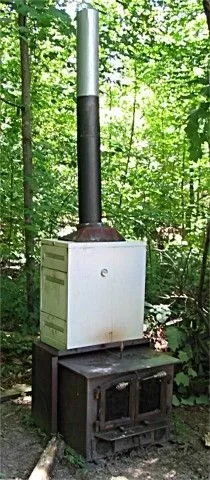

1425 F.
After that it is now in the back of the yard as a meat smoker.
By the way, you don't need a chimney fire at that stove top temp to wreck a chimney. Remember that the surface temp of the stove is around half of what is happening inside and going up the pipe. The liner that was in that chimney is laying right behind the smoker.

Is that a file cabinet jammed on the top of the stove?

Maybe that is the meat drawer ????

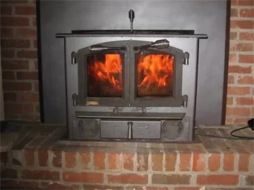

Accurately measured by IR thermometer or estimated by eyeballing the color?
Stove top thermo was pegged at 1,000 F and the IR thermo said 1425 F. At 1125 the stove paint in the top center went "poof" and disappeared. Followed shorty by the paint on the magnetic thermo. The 3/8" inch top plate was glowing cherry red.
Thought I had found and fixed the problem. The exact same thing happened the next night and the stove went out of the house the next day.
This pic is fifteen or twenty minutes before it headed to the moon. When I shut down the air controls it took off.

Yep. A aluminum broiling pan fits perfectly in all three of'em.
