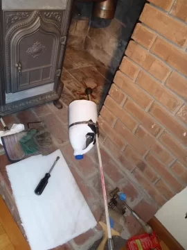

    Here are some pictures of my cleaning setup with a soot eater. A large hose clamp , plastic jug and the vaccuum cleaner line attached to the bottom , make for a quick and clean bottom up cleaning.

    Thanks for the pictures of your setup. Looks great.
