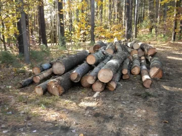

    I agree also, Burn it. I like my splits of pine 18" to 20" long. You will be surprised how long it will burn if the splits are decent size. Here is my late winter work.
