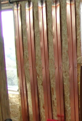

Here is a gravity radiant wall system that an off-gridder friend built. He bought ThermaFin, solar collector absorber strips and mounted them with a generously sized, sloped upper and lower header.
He used greenhouse window operators to move ball valves for "thermostats"
Being frugal, he used Vodka as the antifreeze heat transfer fluid in his solar array. instead of glycol.
Larry lives in Northern California and like to talk solar and off grid living. i can put you in touch with him to share data.
hr

That would be great. I'm having a devil of a time finding formulae for gravity systems. I found a few @ engineeringtoolbox.com. I am trying to figure out what pipe size i need but manufacturers don't list head loss numbers for thier piping below what is considered a minimum pumped flow rate. In the CI radiator thread, there's a pic of a cat sleeping on a gravity-fed rad - the pipe for that one rad must be 1 1/4! I'd like to use pex for the smoothness, cost and corrosion resistance, pex supply has it up to 4". I'd like to move 100 000btu. Lots of homework to do yet...
