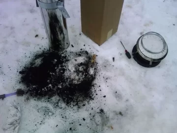

Anybody got any opinions about my chimney sweep who sweeps from the inside instead of climbing to the top of my 45 foot chimney? Maybe he knows that it's not worth the trouble of taking off that cap on the ~12 inch round clay liner?
Sweeping from the bottom should be fine in most cases, but don't forget cleaning the cap, spark arrester/screen. The brush coming up from the bottom will not do that job. If the screen is nothing more than 1/4", or larger, hardware cloth, it may be ok.

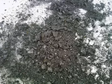

I can attest to that. The caps we use the screen is 7" or more in diameter. A 6" brush just makes a channel in the cap leaving 1/2" ring of creosote stuck to the cap. Lets see if these pics work, its what we cleaned out of a cap from a person cleaning their own chimney from the bottom. Remember all this came out of JUST the cap.
They were having a slight problem with smoking coming back and puking out of all the pipe joints inside the house.

If I could not get to the top of these chimneys for cleaning, these stoves would never be lit up again. When the old knees keep me from going up there I will either hire the job out or find some other heat source. I am highly allergic to carbon monoxide. I understand that it is a common allergy. :coolsmirk:
