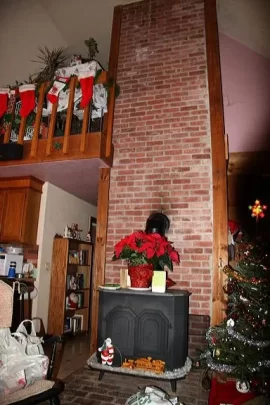

So this year I was looking around for a new stove and found my neighbor replacing this Resolute Aclaim with a gas fed stove they use more for decoration and to take the chill out some mornings than any real wood burning. I bought it from him for $200. What do you think?
I think it was purchased new in 88 or maybe 89. They haven't used it 50 times since then. The husband works outside the home and the wife couldn't be bothered. Plus, they did mention they had a hard time controlling the heat and it would get too hot for them. I've also noticed this stove runs hot. I am always a year ahead on my wood, so the wood I'm burning now I cut and split last year. I go through about 3.5~4 cord a year. Sometimes a bit less, or more.
I decided to put a stove damper in and located it about 8 inches up from the collar. That is helping me control the heat, that and I'm starting to get a feel for this stove. On the griddle temps will run up to 750-800'F but the stove pipe with a magnetic thermometer is about 300~350F. I know it's burning clean, but I barely get a burn through the night, filling it up at 10:00PM and usually I'm down to just a small bed of coals by 6:00AM. But it's usually enough to be able to get a burn going again pretty easily.
I will say I love the pretty glass door and the top loading. But it seems like the EPA regs forced VC into building a stove that the end user has very little ability to control the heat output of. Am I doing something wrong? I've got this in the basement of a 2 story Cape, so it's about 30 feet of chimney so I know I've got a good draft going there.
So now I'm trying to make sure I've got the directions right and have found a couple of versions of the user manual on line.. and there were apparently some changes made in the first few years of this stove. This one doesn't appear to have anything to "shake the grates" but there is a small bar the runs from the left side of the stove under the grates and fits into a small hole in the front grate.
Any hints on this stove? Were there problems with this stove?
