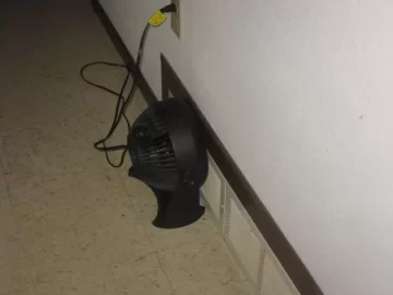

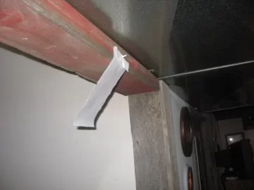

    Been readin over and over on here how to move heat upstairs. Normally I just relied on natural upward movement of hot air to keep the upstairs warm. Tried a little experament.
    Cold air return to furnace about 15 from stove.
    It really does speed up warming the upstairs by quite abit.
