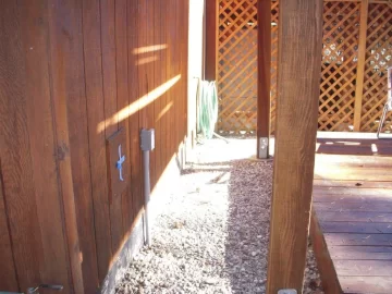

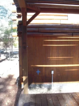

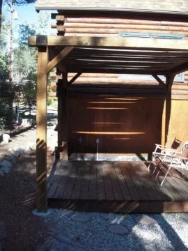

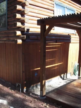

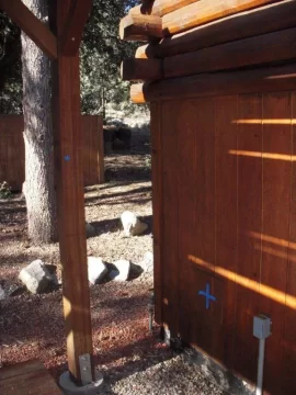

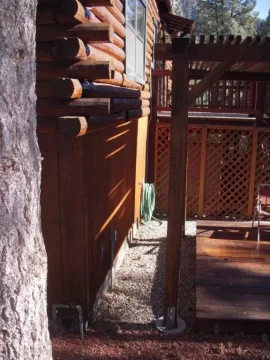

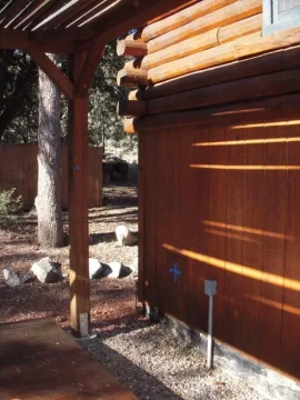

I am hoping to install an Englander 25-PDVC on an existing brick hearth which already has a vent hole running through the exterior wall. I need the "high altitude" 4" vent kit for the installation since the stove will be at about 5200 feet. The blue "x" on the wall in the pictures show the location of the current hole in the wall that I would like to vent through. I had a couple of install questions:
1. The room where this stove is to be located is underground by about two feet. (in other words, the blue "x" that marks the vent hole you see in the photos is about 2' above ground on the outside of the wall and about 4' above ground on the inside of the wall). Would you consider this to be a "basement" installation? It seems from the installation instructions that there are a lot more things to worry about and consider with "basement" installations.
2. The stove installation manual states "Never terminate the end vent under a deck, in an alcove, under a window, or between windows." Otherwise, it doesn't give clearances for the exterior chimney pipe. I am planning to use Simpson Duravent AC3100 kit for the chimney, but haven't been able to find much on the Internet about clearances for that kit. My concern, as you see from the pictures, is the redwood deck and deck covering that is near the exit point. Will the chimney be too close to the deck covering if I use this chimney and terminate it under the deck covering? (For a distance reference, the closest post of the redwood deck covering is about 30" from the exterior wall. The top of the deck covering is about 8' from the ground).
