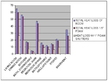

I made a spreadsheet to calculate my heat loss in the new house when I started building and learned, as Nofossil suggested, that the heat loss through the windows at night quickly become a larger and larger fraction of the heat loss.Let's see if this chart will post...
You can see that if I add only 1" of foam to those window walls (maybe R6) I would lower the heat loss from those larger rooms by a lot more that adding lots more to the walls. There is no exact point where this changes, it just is a continual slope. I drew the line at not adding any more to the walls AND not bothering with insulation over the windows at night. That's my personal point of diminishing convenience.
The 3 columns are heat loss with just the 6" walls, with 1.5" foam added to walls, and putting 1" foam on windows.

Nice chart Dave. That's what I was getting at with my heat loss numbers, but mine would be even more dramatic with over 400sf of clear glass instead of low e.
