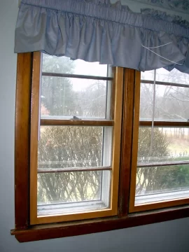

I have double hung windows and I' recently caulked and weatherstripped them but I know they're still going to be a source of air flow and heat loss. I've seen companies that make interior storm window inserts and also video on youtube of people that have made their own.
I just wanted to see if anyone's had experience with them. It seems like if you could get them cheap and they're a simple no fuss no muss push in/pull out style then they might be worth it.
