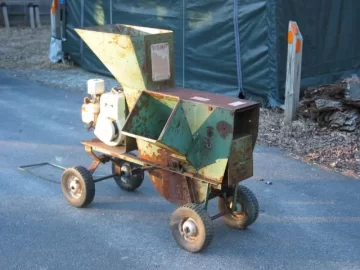

Why not use your other new disposal unit... place under sink when not in use in yard, problem solved.
  • [Hearth.com] Is Garbage disposal now garbage?
