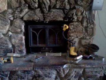

    How is the flue temp monitored? I got my first burn in last night. I have Jotul C450. I was unable to get my faceplate on, So I can see my flue where it enters the insert. I burned some cut up redwood 2x6 decking, got a full box going pretty good. My flue was glowing orange where it enters the insert. I had the air turned to half way, and lowered it to 1/4 and the glowing faded. My liner wouldn't bend enough get it into the insert at the proper location to install the surround. I need to get the insert pulled out of the fireplace cavity another 6 inches. The surround looks nice, but it still heats the house well without it. Maybe someday I'll figure out how to get it pulled out more to get it in. With the surround I would not have seen the flue glowing.

    Bump. This thread was about burn tubes glowing inside the firebox. Chimney pipe glowing is different and would scare me during the first burn.
    I think it got too hot.

    for sure get that fixed asap
