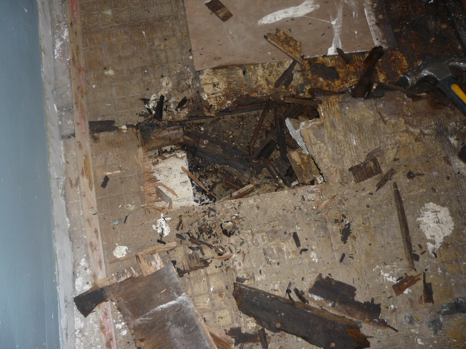

    Lol...or, you could have a leak that IS detected but then just covered back up instead of being fixed, like this:
    [IMG]
    that is cement/thinset that was used to fill a hole in our wood floor caused by the leaking tub I mentioned before. It was then covered up and they laid carpet. A squishy spot which was a slightly darker color was our notification that there was a problem.
