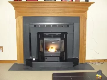

My decision to install the Quad, CB 1200i has finally come...Installation went well, and she is running great.. Few initial questions..
1) Thermostat Placement: 1st thing on my list is to ditch the chincy mechanical thermostat and replace with a digital/programmable one..However, more importantly I have questions on placement.. I always thought that you wanted to place it 10-20 feOUtet from the stove..but the tech today told me, that 1) I can not add wire to the thermostat, and 2) Best spot is directly above stove,,right by my mantle..Theory being that will register "true" room temperature better than on an opposite wall.. Thoughts/feedback/advice??
2) Surround: The standard surround is too short to cover the opening..will have to have larger one ordered.. Anyone have a guess on price difference? Just curious?
3) Outlet: The unit is plugged into a standard wall outlet, however is there a need to run this through a surge protector like any other high valued electronic device?
I have been squirilling about 6 different brands of pellets and will by my first ton following this...However Tractor supply by me is selling a 1T for $225..both Lignetics and Hardwood heat.. seems like a steal, right?
Lovin it so far..things throws off some nice heat..
