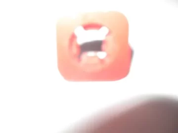

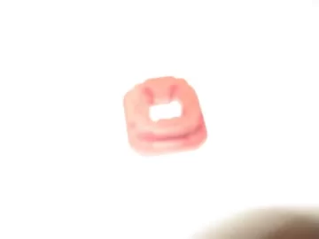

Can you post a picture of the mount? I might have something kicking around downstairs. I may not have the right mount, but I could have the isolator that split?
Here ya go J-takeman, The front dimension is 7/8" back side is 3/4" and 3/8" thick. The square hole in the convection blower is 5/8" square where this goes.
