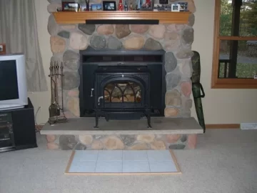

I had the same dilema this summer. The firebox on the Oslo is 2.0 cubic ft. The Castine is 1.5 cubic ft. I went with the Oslo and am happy I did. I too was worried about being overcome from the intense heat, but thats not the case. I usually run the stove between 3-400F most of the day and night. If I am trying to take the chill off after being gone I will run it up to 600 for awhile but then go back down to 3-400. I learned that you can always run a big stove a little cooler, but can only run a small stove so hot. Plus the side door loading is worth every penny, no mess and no chance of a hot ember or log rolling out. Get the Oslo, you won't regret it. When I bought mine the Oslo was only $100 more... 8
