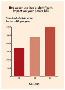

I do heat the DHW with oil and since the fillup I had on the last day in September, I currently have 1/2 a tank of oil. Therefore if I use 275 gallons of oil per year at say $3.00 per gallon if I buy in the summer that is $825.00
Does anyone know how much an electric hot water tank adds to their electric bill per month???
If it is $50 then it would be $600 for the year but I have no idea??
If it is $100 then it would be $1200 for the year but I have no idea??
I do have a 40 Gallon Water Tank so that would be 3,500 Kwatt hr per year of electricity usage.
http://www.wapa.gov/es/pubs/fctsheet/WaterHeating.pdf
Variables will keep us from giving the exact answer. Depending on its tank size, utility rate, temp setting and amp draw. Most have a energy tag on them that gives a breakdown of about what it will require for month/yearly use. My 4 year old 60 gallon unit has a $410/year use average. Reading the fine print the rating was in 1994's utility rate. I would say mine is more in the range of $700/year plus. And thats also using a timer to control its on/off time.
Do your home work here. It may take many seasons to repay the investment. I had no choice as my house is all electric.

When I want to figure out if electricity is better I just use a few electric bills. Take the total $ bill amount and divide by the total KW value. This gives a decent estimate of your actual $ per KW including ALL charges. Around here it is $.185 per KW.
Electricity is 100% efficient so a 5KW water heater on for 1 hour would cost: .185 * 5 = .94 or almost $1 per hour. How long does your current water heater run in a day and watt is the heat BTU value of it?
