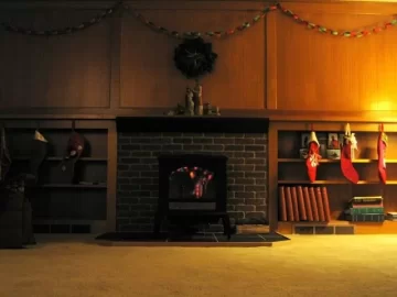

PS in the picture there is a fire in the stove and the strange lights is a reflection from my Christmas Tree.
