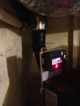

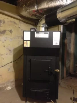

    I ran seperate supplys for two reasons 1- my furnace is 20ft from my oil furnace. 2- even if they were close there is not a way to make the 8in air duct from the kumma go into my oil furnaces plenum. So what i did was I ran about 15 ft of 8 in coming from my kumma down the middle of my house and reduced it to 6in for about 10ft. off the 8in pipe i have two 4in pipes feeding two registers and two 4 inch pipes feeding two registers off the 6in. And the return is sucking from the basement.

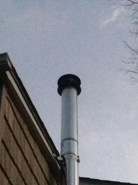

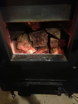

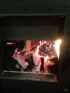

    That first pic is just to show how small the fire box is. I think its about 2 cubic feet. It holds about 15in wide and 18in high worth of wood without iit getting hard to cram more in. The pic of the fire working is a pretty good indication of how the wood burns. There is no fire at all when you first open the door. That little bit on the left just flared up at the last second because the door was open and a lot of air rushed in. Normally everything in there is just glowing with no visible flames. My stovepipe that connects my chimney to my furnace never goes above 150 -170 and I have about 10-15 min of smoke in the beginning of each load. so thats 30 min of the lightest smoke you can imagine every 24 hours. I have it dialed in pretty good and have learned that the way you place the wood is key and can make up to an hour or so longer burn. That pic of my chimney is after 12min of reloading a full load. ( Yes I stood out there like a jackass with a stop watch ). I was loading three small loads a day but realized that if I just stack it to the brim I can load it at 12 and 12 and my house stays at 73 for about 8 - 9 hours and drops about a degree an hour till it hits about 68 when I reload it. Mind you this is with crappy multi length pieces of wood, uninsulated ductwork, no return set up, and only three registers that are far from the furnace. I am ducting in two more registers that will be closer to the furnace which will give me more heat into the upstairs do to the great temp difference from the air in my duct work close to the furnace compared to where the registers are. My goals are to raise the temp a few deg with the improvements to the system that I just mentioned and to get 10-11 hours next year once i start using wood cut to exactly 17in and is all locust and oak. You guys think that the improvements to my system that i have not made yet will give me a few deg more once completed or a waist of time???? DID I MENTION THAT I HAVE USED NO OIL YET!!!!!!! This time last year 800.00 in the hole already!
