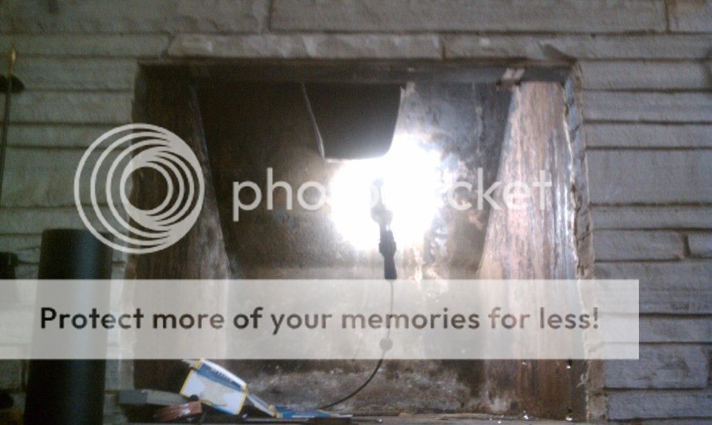

    I know, I know... projects always take 1-3 extra trips to the store but the closest one is 25 mins away so I'm trying to avoid it this time. Good call on the tapcons... was planning to secure blockoff plate to existing heatform but if I decide to put it up higher in the chimney the tapcons will be needed. Not sure why I was going to paint the block off plate other than it seems like it's generally a good idea to paint bare steel... but I guess it's not really necessary.
    I spent a few hours drilling/sawzalling an opening through the smoke shelf/dampener area in the 1/4" steel heatform earlier this week so it should be a straight shot for the liner. I have to give a mention to this Diablo sawzall blade as it did a damn fine job cutting through some pretty thick steel. Here is a preview of the hack job... will post a detailed thread once it's all done. The holes in the lower right side are the start of where the OAK will be run.

    Is this liner going to be fully insulated? That gaping hole makes me a bit nervous. Is this an exterior wall fireplace & chimney?
    Also, was the chimney fully cleaned?

    Check, check, check.
    Interior fireplace/chimney. Rigid DuraLiner is factory insulated and the flex section will be as well. It was tough enough cutting straight lines into the smoke shelf, I wasn't about to try and cut a 6 1/2" diameter circle. Not sure whether it's best to build the blockoff plate right at the smoke shelf area I just cut out, or higher up in the chimney a bit.
