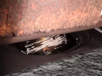

Silicone should NEVER be used on a wood stove pipe. If the opening is small, it should be sealed with furnace cement. Can you put up a picture of this connection?
Here's the picture of the connection. That white stuff is the cement originally used to connect the collar to the flue pipe. The black stuff under it is the rubbery stuff he put on yesterday that made such a mess.

Moving the stove after it was connected would compromise the connection if it crimped the flex liner and/or if the flex wasn't securely screwed to the stove collar. Is the flex now hitting against the lintel? If so, the stove needs to be moved back into the fireplace until the flex can naturally bend to completely surround the stove flue collar.
PS: black silicone is definitely not what should be used here. The problem needs to be fixed and not covered up. Particularly not with a product that is not approved for this application. Get that gunk removed.
