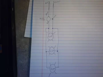

I have a couple lights on either side of the garage door, and I'm going to add a third around the side. If I add one with a photocell, can I wire that in line and have it control the whole string? I'm thnking it would need to be the sort that have a battery, because the cell must take some juice, right? Or is it some sort of really tiny relay?

it's a relay.
It depends on how they are wired.
but the first in the line should be changed, not the last.... Switched neutrals are not good...
As they're wired now, I believe they are technically in parallel - 14-3 comes from the box, through a switch on the hot, then each of two fixtures is connected to both the hot and the neutral. Based on the physical arrangement, the only real option is to bust into the box for the last fixture, and take a lead off that. If I understand what you're saying, you'd recommend rearranging the wire so that they are in series - a continuous hot out to the photocell, then each of the other fixtures in series on the neutral?
Steve
no
see drawing attached (it's pretty crappy)
hot and nuetral are from box
1st light in the circuit if it has 3 wire photocell (or use an external photocell)
power is switched by photocell and breaks power to all lights in parallel downstream via daisychain
neutral is unswitched and just daisychained, back to box...
I hope this helps....
