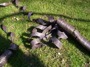

If it is loose, you should be able to make a hole in the chimney somewhere above the tee and have it fall out. In a perfect scenario that would work. May have to make a few holes. If the liner is rusting ???? it should be able to be unraveled from the top. Just work one of the seams loose and pull, it will unravel. Like this....Link Removed

So sounds like it's maybe a poured vermiculate insulation? It's not like a blanket liner that is just loose around the pipe or anything?
I wonder how the liner would/could rust out... but if it's a poured liner like vermiculite it sounds like a pain even if it could be unrolled like shown above...
If it's that kind of insulation I suppose the options would probably be either what you mentioned (running another liner inside it) or having to take all the poured loose stuff out, either one sounds tough. Only other thing I can think would be attaching a new flex liner pretty securely to the BOTTOM of the old liner pipe and fish the old stuff out the top, thereby pulling the new pipe up into the same vacancy where the old one was. That could work, maybe? Probably have to put a NEW rope down the old pipe, attach to a leader cone on the new flex, and pull that up at the same time you are pulling the old stuff out. If the old stuff is really seriously damaged, it could be hard to pull out though and cause problems for the new?
