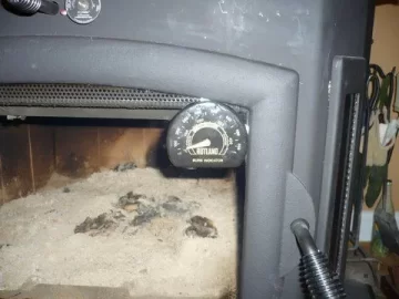

Just wondered if this would be an ok location for the Rutland?
The Buck has an air jacket around it and I use a double wall pipe so there is not much place to put it.
  • [Hearth.com] Location for thermometer on Buck 91
How are you mounting the thermometer to the glass on the door?
I'd suggest up by the cat probe thermometer. Stove is single wall in that location. You can pull the probe and see the catalyst when it's glowing.
I got a piece of metal strapping and slid it in the corners and stuck the magnet to it.
I went ahead and put it next to the cat probe and it went up 50or so degrees.......guess that would be the best spot. I thought the glass would be better but the strap being off the glass made the spring off that much more.
thanks pgmr
You're welcome. I used my infrared thermometer to find the hottest spot above the door and right next to the probe was it, so that's where my magnetic thermometer went. I'm not looking for absolute accuracy with that thing, just a relatively close number to compare to previous burns. Seems to work fine for that purpose.
