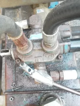

    Here is a pic. It broke at the lower hole. I have since spent an hour re fabricating it only to cause it to crack again. It works, but it won't work for long being cracked.

    I'd re-fab it from a piece of flat stock. It'll be much stronger that way, especially if you get a piece that's slightly wider than the original (same thickness so that it engages the spool properly) near the bottom.
