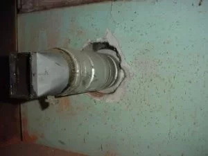

Yes - the vent runs the whole length of the chimney from basement to cap - there is a peaked vent extending out the top of the chimney and the old chimney has been capped with a plate - which holds the vent pipe up I assume. The stove is on the first floor and the primary vent from the stove has been cut through to the old chimney where it meets the run of vent with a t-fitting.
What I am wondering is, can I simply remove the run of vent pipe and exhaust directly into the original chimney (assuming I pull the old vent out) from the back of the stove? The chimney is very sound and has it's own ash pit in the basement and frankly, I have to say I think the pellet stove would probably breath a whole lot cleaner.
There wasn't much soot at all in the bottom - but got a grocery bag full when I ran the sweep up the pipe first time, and today several hard cake bits from the top. Here's a shot of the install from when we were renovating - so you know - there is no plaster or lathe - the wall is concrete direct on firebrick.

But if not for the tripping of the vacuum switch,would all things be ok ? I mean as far as draw...any problem getting past a lazy flame in the pellet stove.I would think that would be the main thing to look for. In my situation,I'm in the basement also hooking into the chimney but it is lined with stainless pipe that is 6 inch-to handle a wood stove.There is more than enough draft.You say the stove is three years old-depending on how much pellets you have burned,it should have been thouroughly cleaned a few times by now.All I've got for now....yes a fellow eastener-living in the snow belt and about to be hit again this Sunday.

There is no reason a full liner shouldn't work. Really and truly, you're probably better off leaving the liner alone than dumping the pellet exhaust into a much larger cross-sectional chimney. Sounds to me like you just need some extra combustion air. IMHO though, that many feet of liner should have never been 3 inch. I would have required 4 inch liner because of the long pipe run. You're making the exhaust blower in the stove fight against a lot of frictional resistance in a pipe that long, imo. However the increased cooling and decreased gas velocity in the unlined chimney will probably do as much harm as good.

We are talking about a 14 inch chimney straight chinmey from basement to stack top (no bends, no caps) originally lined for coal in 1921 - if I were 12 again I could probably have crawled up it to the roof. I thought, and I may be completely off base, but I thought that with this sort of chimney it would be pretty much like venting straight out through a wall.
This assumes however that natural draw doesn't come into play so much with a pellet stove.

A 14 inch chimney is a pretty big hole and in my books is basically outdoors. I would wonder about the insurance company-you never know and if they say no way...well,it kinda makes it an easy decision unless you are into risks like that. Eastern Embers makes a good pellet-lots of heat-spruce so the bag says.I've often wondered what alder would be like as a pellet...or cherry wood. If you ever burned it in a regular stove,you have to watch you don't melt the thing! Wow it gets some hot!
