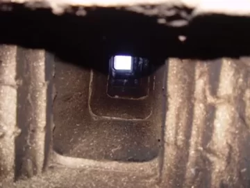

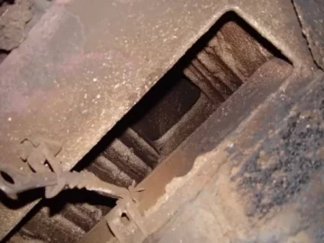

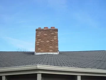

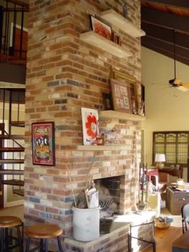

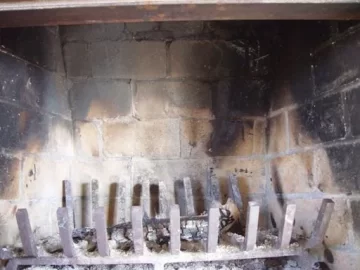

    I’m new to the forum and am looking for options to convert my fireplace to something I can use to heat my house. I live in Minnesota so the winters can get really cold and the house has a forced air, natural gas, furnace. The house is 1 ½ stories, 1800 SF, with a vaulted ceiling and sub-par insulation for this climate- insulated 2x4 walls, allot of windows and the roof is around R-16. The living area is totally open with the fireplace in the middle of the room. There are ceiling fans mounted on each side of the fireplace. I expect on the really cold days I’ll need to use the furnace to supplement the wood burning heat. I’m not worried about heating the bedrooms as I have electric heaters that work well in those small rooms.
    The fireplace dimensions inside the house are 6’ wide, 15’ tall and 29” deep. So it’s pretty big. The total chimney length is about 17’. The firebox is 32” wide at the front- tapering to 23 ½ “ at the back, 24” tall, 22” deep at the bottom tapering to 19 ½ “ at the top. I’ve attached pictures showing the inside of the chimney, firebox and fireplace. The firebox is not in an optimal position on the fireplace. The fireplace splits the living area into two large areas on the left and right, the firebox is facing what I use as a dining area between the two large areas on either side.. When I have fires the heat radiates into the dining area with very little heat reaching the areas on either side of the fireplace.
    I don’t have room to put a stove in front of the fireplace so I’ll need some type of insert. With a decent burn time I should be able to keep a fire burning nearly full time. Because there is so much mass to the fireplace and my burn times will be long, I’m wondering if I should be trying to transfer heat into the fireplace and allow that to radiate heat into the space? From the reading I’ve done it seems that most inserts are designed so they don’t transfer heat to the fireplace.
    Any advice on products and installation would be much appreciated.

    Transfering heat to the fireplace will be next to impossible. Most will go up the flue. You will want a good insert with a blower. You will need to install a Stainless Steel liner, and a block off plate would make it even better. There are alot of options out there for 1800 sq. feet. Look at Lopi, Regency, Quadra-fire, and for a prettier option, Jotul and Hearthstone. There are alot of options out there, these are a few of the more common ones.

    I did some research on here earlier and found instructions for how to make a block-off plate, I’ll definitely do that for the install. So it sounds like I’ll need the biggest unit that I can fit along with a fan? I take a look at the units suggested and report back.

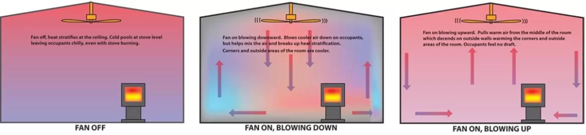

    I’ve got another question too, looking at a thread earlier there was a comment saying the ceiling fans should be pulling the air up. Can anyone tell me why this is? I currently run mine on low pushing the air down, I figured since the heat was rising that I’d want them to push it back down. Sounds like I should be running them the other direction maybe?

    The big difference in reversing the fans is that it creates draft free air circulation that works with natural convection instead of against it. It is the nature of air to sink as it cools. Reversing the fan works with sinking cool air on the exterior (cold) walls creating a more even warmth and draft free circulation.

    I'm glad you asked about the ceiling fans. I'd forgotten I even had the darn thing. I used it all summer and hadn't yet thought to use it reversed to stir things up. On low or medium I don't feel it at all. bg, that illustration is pretty good.

    I'm a firm believer in working with mother nature wherever possible. Reversing the ceiling fan is similar to blowing cold air down low toward the heat. It works.
    Of course, if you like the house at 80F then this may be a moot point when you are running around in your underwear. The cool air of a fan blowing down on you may feel great at that temp.

    That makes since, nice illustrations. I've never had a house with tall ceilings, only flat, and smaller rooms really. I couldn't see any difference in my personnel situation.

    Beautiful central chimney. The layout remind me of this dome house.
    I have Lopi Declaration insert and quite happy with it even though it's a bit too "hot" for mid-Atlantic climate. You may want to look into their (on FireplaceX brand though) new hybrid fireplace insert or the Elite 36/44 as in the link below.

    Thanks much for the explainations and illustrations regarding the ceiling fans. I'm gonna try reversing them and see if it changes how the room feels.
