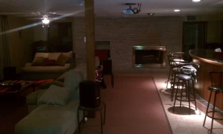

Thinking about adding another stove... Won't be used 24/7 but dunno what to do.
Gas logs? Pellet stove? Gas stove? Wood stove?
Thinking about freestanding , but taking the fireplace down to the tiles ...
Width is 48"by 32 by at least 2ft deep
I have a summit insert upstairs same size fireplace and shroud barely covers the opening - big fireplace
Looking for ideas/suggestions

It's in my basement about 1300sq ft.....
The fireplace is so large I was thinking bigger stove , not planning on anything more than the basement but if we lost power and the heat can go upstairs hey why not.. basement is finished and mostly insulated but not 100%

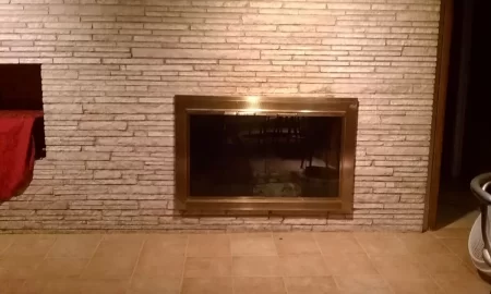

Here a better shot from across the room ... Main room is 24x30

Just measured my fireplace and it 29 inches deep will be very lucky if it fits flush as a freestanding .. might have to pass and look for something tad bit smaller ..... But thinking steel stove as the fireplace wall is massive and will soak in a lot of heat
iceman said:
Buck says you can pipe it past the damper in a fireplace so I think that's what he did.. a no-no for us!
You can get a leg kit and install the Buck as a freestanding stove. That's the only difference between their stoves and inserts.
