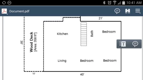

    Here is a blue print oh the home. this one dosnt show the walls between rooms but there walls between all the rooms. The house has electric heat that is the reason for the solid fuel burner.

    Gas electric heat?Basement?Registers?

    Has electric heat typo. The stove is in the basement. The registers in the floor are grates that allow the warm air to naturally come up. I'm not sure if that's what you are asking.

    With the stove in the basement and floor registers you could put in one of the big pellet stoves,as the extra heat in the basement will not affect quality of living,unless you spend a lot of time down there.And the noise will not be as noticeable.For upstairs almost any smaller stove would be fine,perhaps look at the small englander.Don't forget about expense of providing outside air for stoves.The big enviros are supposed to be good quality units but have never worked on one.

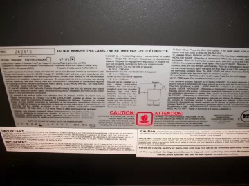

    Thank you for your input. I have found a stove called the vista vf 170 it looks exactly like the enviro maxx and the tag on the back says both vista 170 and enviro maxx with the box for vista 170 marled is there a difference in the quality I found a place in New Hampshire that has the vf 170 for a very good price. I have attached a picture of the back tag vf 170.jpg

    Hi Joe- I can tell you, the VF170 is the sister to the maxx-1, no pot stirrer. The Enviros are a well built stove, they are durable but this unit is kinda noisy. If that doesn't bother you, they are fine heaters, one of the few that can rightly replace a wood stove's heat output. The M55 steel might be a good choice for you too, but it does have a smaller hopper. For upstairs, maybe an Enviro EF2 or perhaps a Quadrafire Santa fe is price is needed to be around 2K. Enviro (Sherwood industries) makes a lot of good stoves, for two or three other than themselves Mfrs, a Hudson River Davenport might be a good choice too, its a digital version of the EF2. Good luck on your search.

    I agree on the vista,I would own one,but do not know if he needs an expensive stove upstairs for a part time unit,but they are pretty.
