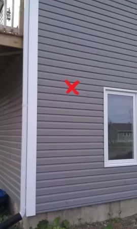

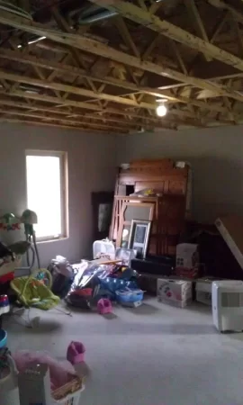

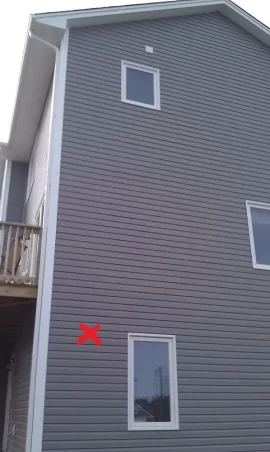

    been checkin out the forums here, and this is by far the most informative site Ive found. Now, I have been looking into a pellet stove, i live in southern NB and dont want to spend more then 4000 when its all said and done....my problem is that i want my stove in the basement, which is insulated but unfinished at the moment (soon to be completed). My house is a two story with a walk out...
    Problem is Im not sure how to set up my venting, I was looking at the kits at home depot http://www.homedepot.ca/product/3-in-pellet-pipe-kit/945807
    But i worry that it would blow back onto my house and damage the siding,......I would go completely vertical but it is just not sensible to go up 3 storeys,,,,,,, looking for advice on how to set it up.....and a good solid stove. Any advice appreciated, Ive included pics....i want the stove to go in the corner in between the window and vent were I have the x....
    ....I would like to put it in the corner (if you can see past my junk haha) thanks in advance!....

    As far as the venting you gave the link for, if it's installed as per manufacture's instructions, it should be fine....there are MANY forum members who have used that type w/ no problems.
    BTW, is that side of the house facing the prevailing wind? Any plans to add the OAK?

    Luckly the wind usually slams the other side of the house, and yes i would like to add an OAK, would that be an issue so close to the ground?

    If you are venting where there are windows make certain you follow the clearances provided by the stove manufacturer otherwise it won't be stains on the siding that will be an issue just smoke (very bad for you) and CO (very very bad for you) coming in around or through the windows.

    Blow back or soot on your house should not be a problem.. Follow Manuf instructions and kkep it clean. Wont have no soot... 3 yrs and I got nothing..
