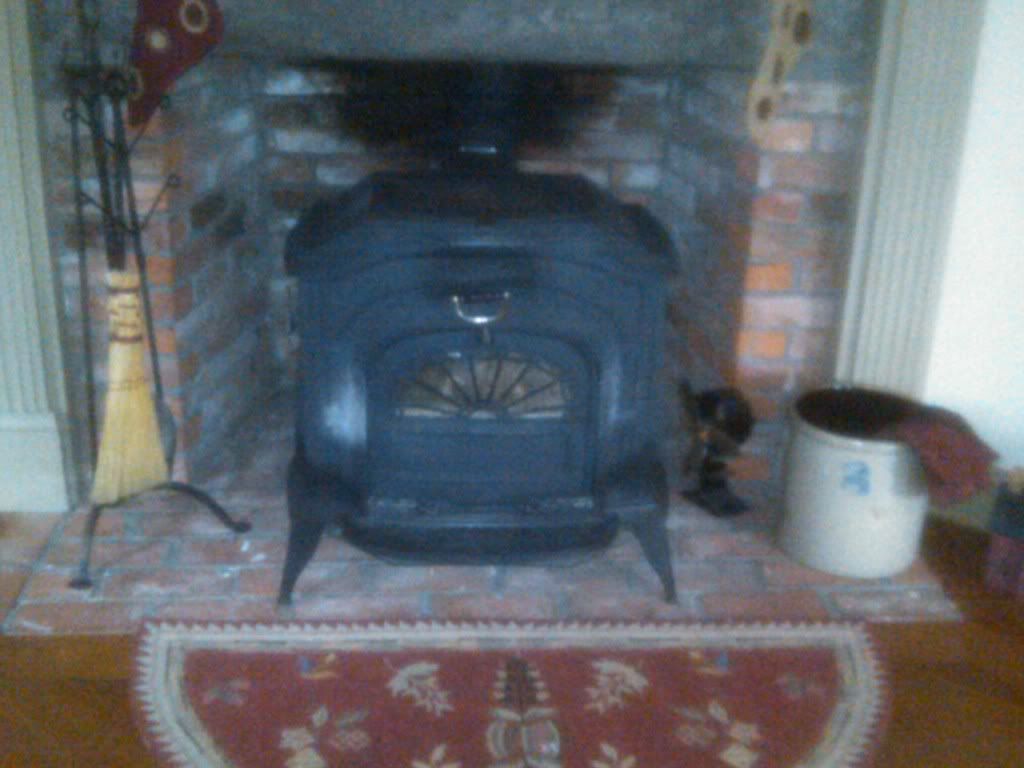

I burn about 1-2cords per season (weekend burner, and when I'm working from home)....to help supplement our hot forced air propane furnace. Our home is an 8yr old colonial with a center chimney. See pic.
The Stove is in the fireplace facing the gathering room.

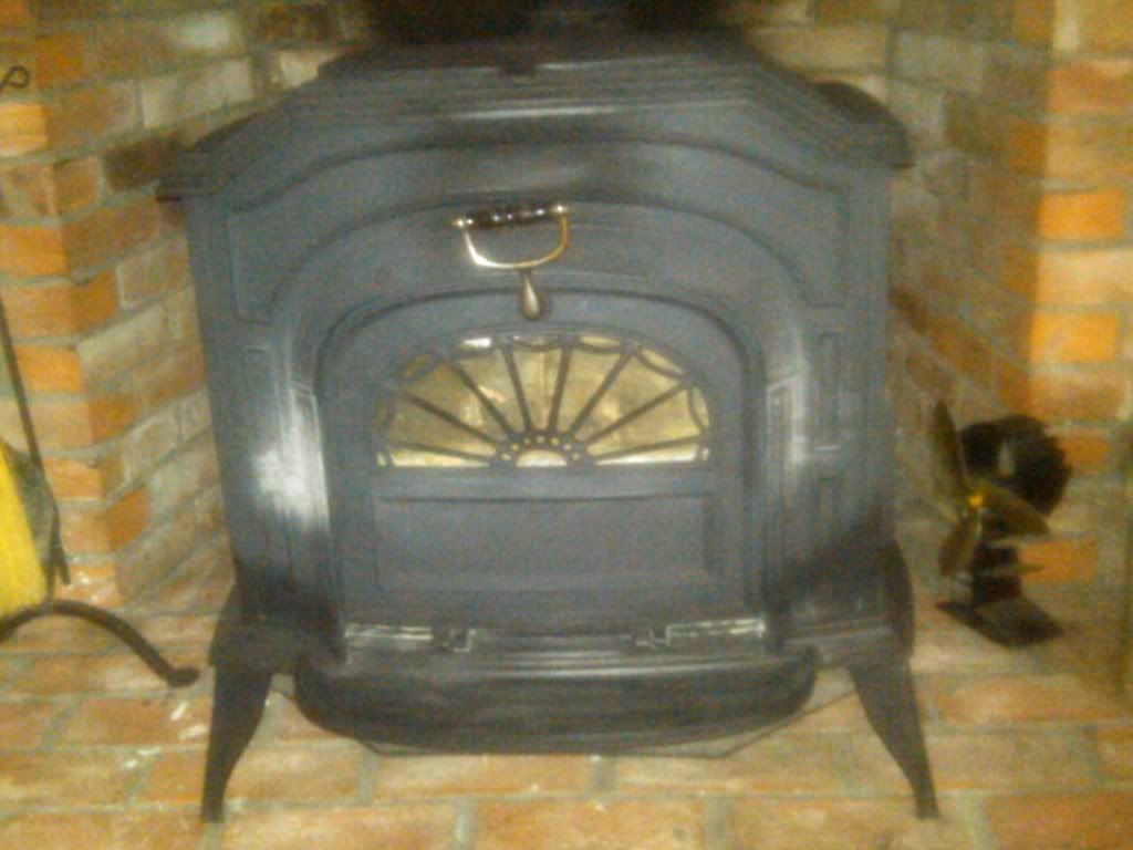

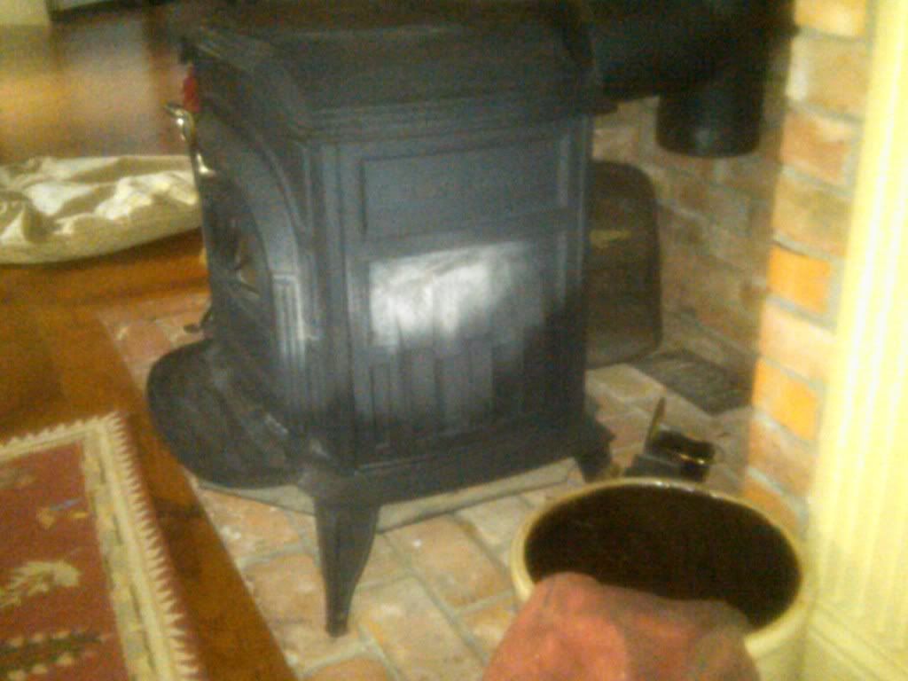

Here are some pics of my current set up. You can see the white/grey patches that I mentioned before.
Thanks for the input!
Ya, I'm guessing that white glaze is from overfiring the stove. Looks like maybe the door gaskets were indeed leaking and things got real hot on the sides.

The funny thing is for the side white glaze, its only on one side. I can't see any visible cracks in the guts, so I'm not sure why it is doing that.

In that first pic I'm seeing a white film on both sides of the door, right??? And yes, that one side is definitely white.

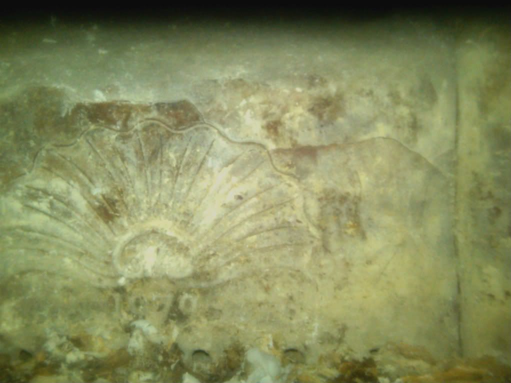

This morning I took a closer look inside the stove, and behold, there is a 6" long crack in the back plate of the stove, on the right side. See pic.
I'm guessing that during the last power outage (where we were without power for 8 days...and I was running the stove 24/7), it might have been too much for the stove.
30 years old, and as far as I can tell, its all original..except for gaskets.
Your thoughts...fix or replace?

I've got a hunch the stove can be fixed. The crack can be repaired. I think VC actually sold a repair kit for things just like that crack a long time ago.
To me, that was admitting a flaw in the stove. But 30 years is a long time to run a stove w/o stuff like that happening.
Probably just depends how much money you feel like spending and how much of a headache you wish to deal with. If I were you, I'd start a new post showing the crack, the white "overfired" spots, and ask advice. I just don't feel right directing you one way or another.

Also, the hearth for the current (and future) stove is inadequate. A hearth rug is a poor substitute for a proper, insulated, non-combustible hearth. A proper, permanent hearth extension should be considered.
