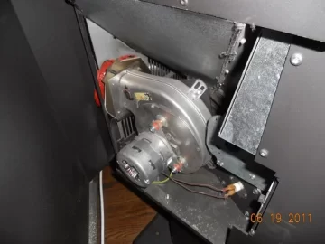

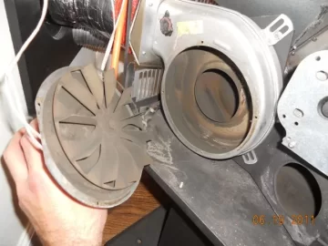

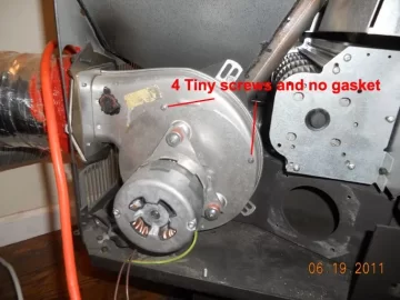

Anyway, as you can see the motor mounts onto the housing unit with no gasket. It is held in place by 4 tiny screws. I was a little worried about this being there are gaskets everywhere else, but that is how it is made. I even called Enviro and they said that is the way it is. I do wish they would have made those screws sturdier and added a gasket just to be safe. But to be honest, it sits on tight and no smoke leaks so far as I can tell.

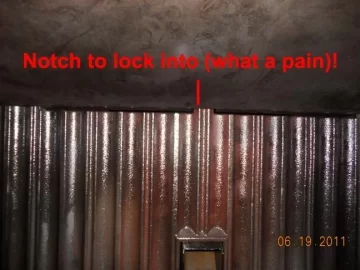

The other design flaw I wish they would fix, is how the heavy fire box liner on the back wall snaps into place with the fire box baffle on top. You have to hit 2 screw on the top baffle and then let it drop on the top end of the liner so they hit together at the perfect pitch to lock in. My elderly father can't do it and didn't even know that it had not locked in until I looked into the burning firebox and told him it wasn't locked into place. The only danger is that the liner will fall forward and get jammed diagnaly in the fire box (never happened to me). It doesn't look like it would reach the door glass to break it, but who wants to deal with that in a cold night with a hot fire going.

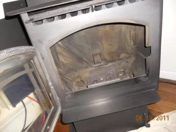

Oh, some of the firebox pictures look oily and that is because after cleaning the stove I added some PAM cooking spray to protect the metal against the humid months of summer in eastern Long Island NY.
