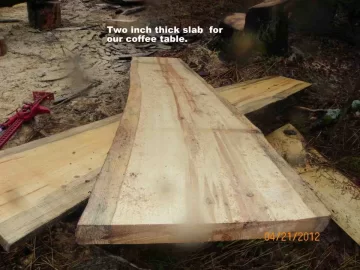

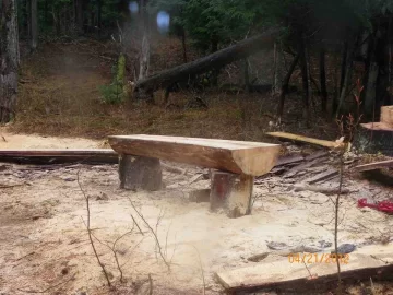

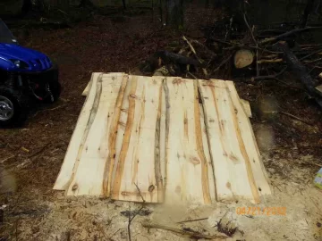

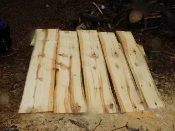

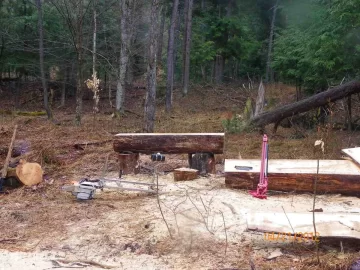

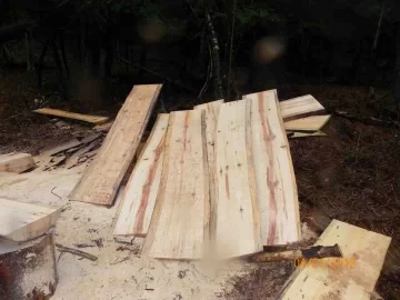

    Mother Nature let me get back to the area I am working then after one board she cut loose. I did a total of 15 one inch boards with one two inch board for a planned coffee table.
    I tapped the air filter out every three boards, last year when I milled in a down pour the filter seemed to collect the small fines quicker, not today.
    Attached are some pictures. 100_4955.JPG 100_4956.JPG 100_4958.JPG 100_4959.JPG

    Little thin for me but I like it alot!

    Are you talking about the slab for the coffee table? What thickness would you make it?

    looking good zap.
    Curious how thick they'll be when dry.
    Dad cut his 1-1/4" to 1-1/2" so when dry & planed we'd get good 3/4" boards.
    Different wood had different shrinkage.
    We'd rick it up & let it dry for 2 years, then plane it.
    Gonna be a great looking coffee table.
  5. zap Minister of Fire
    joined: Aug 25, 2009
    10,372 posts
    I'm not sure but the cabin plans call for 3/4 inch boards so I should be safe. Last year on another site or maybe it was smokin who told me how much you lose, I'll check after we eat tonight.

    Some woods shrink,warp,crack or cup more than others.Generally if you start with 1" or 1 1/8" rough sawn you'll end up with 3/4" once dried & planed.Some years ago I got lucky with some 1" Honey Locust & ended up with 7/8" That dont happen very often though.

    I would start with 2-3/4 no less than 2-1/2 and once sanded with 40,60,80,100,120 grit it would be 2-1/2 or under. (Time you get done with a 2 inch it could look wimpy)

    Once I mill the top I'll put the picture up but the finished product might not be until next year because of the drying process.
    Should I wait two years for it to dry?

    Hemlock it maybe ready in a year. Do you use a drying rack? Best if those big thick ones are up on end.

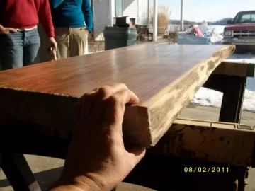

    Its just a rack that your big slabs can stand on end. This lets you flip through them like a book shelve. Now also when doing the top of the table I will use a set of winding sticks and this will get you a nice flat top. http://www.woodnbits.com/new-winding-sticks-in-my-shop/ Its all eyeballs but is very accurate! This one was almost there at 2-3/8.

    Look hard for a wider tree....;) I have done it though. You put the 2 sides together and keep cutting stright through the kerf until they it meets. Forget a joiner all together!

    I like the look of thicker boards for table tops and shelves. Gives it that massive old world feeling.

    I'll shoot for 3.5 to 4 inches on the Hemlock or Pine coffee table. I'm thinking for the legs we will use Hemlock even if we do make the top White Pine.

    Thats probally too thick and very hard to work with. I took a 3 inch slab use the mini mill and cut 3x3 inch legs. Then square it up with the joiner/edger work out nice. There is some awesome metal/iron legs out there I wish I could get my hands on. Wood/iron tables are Bad @ss!

    Zap, my farmhouse tabletop is 1.5". A 2" mill would look great. If you have to glue two boards, so what. Still gonna look awesome. Keep doing your thing man. Impressive.
