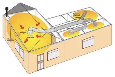

I agree with the things you said about moving hot air around the house! But there is only one problem with your theory:
There are two parts to achieving a good HVAC system. Supply and return. Without return air, supply air will not be as effective. The best solution is to combine both and get the ideal air movement. The level of success achieved with only one of these theories depends on too many variables. So, the end result can't be measured on this thread. The proof is in the pudding. If one more works better than the other in a particular home then that's what should be used. I don't it's a matter of right or wrong here!

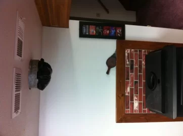

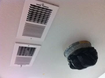

Thats a good point, my solution works well in my particular home, floorplan, amount of insulation (or lack of), etc. Adding another fan blowing cold air towards the stove would probably add good results as well but I've found that I dont need it at this point. I might try it though on a really cold night and compare the differences.
I have thought about putting a corner door fan on my door header. The livingroom is quite a bit hotter than the rooms furthest from it, just like yours. I could see a corner header fan doing wonders at pushing all that heat that gets trapped above the cased opening. Maybe you can put the fan on the bedroom doorway on the floor pointing out and we can compare results!
Thanks for the pics and blue print.
Chris
I think I'll try placing the fans at floor level blowing the opposite direction (towards the stove) then I'll record the temp results from various parts of the house every hour or so and get an average. Then I'll put the fans back up in the original location and record using the same method. I'll wait for back to back days of similar weather to help eliminate that variable and go from there and compare results.
My initial guess is that blowing towards the stove will indeed facilitate convection but those *&%^ transoms will probably be a problem.
Sounds great,
I tried putting one fan from the stove room up high touching the door header...and man...the heat that was blowing out of the room was amazing! I'm curious to see what a combination of these techniques will do!!
