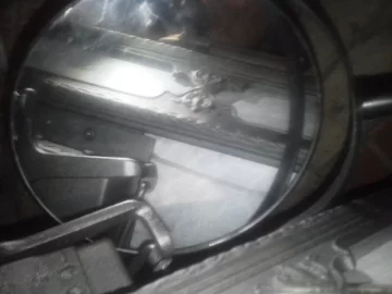

    Alright so its been a week with pretty regular burning going on and I couldn't be happier. This morning I took a mirror to look behind the stove and up the chimney just for to see whats happening. I found a streak of black running down the stone from the corner of the air control lever. It wasn't running really or moving just there. I cant touch it to see if its wet cause its hot bit I think I'm going to let it go out to check it out more. Any ideas what it could be? Ill try to get a pic up but I'm doing this on my phone as the computer is broken don't know if I can do it.

    Figured it out heres a pic.

    Looks like you need a total rebuild;).... I'd wipe it and just see if it continues... bet it was from your break in cooler fires.. Probably has sealed itself with ash. I'd just check it down the road... Woodstock always answers their phone,,, I'm sure they'll give you a heads up.. I'm amazed for a small company that someone has "always" answered the phone...

    now I'm thinking maybe moisture in the stone where it meets the cast plate and furnace cement, it just made that stain... it dribbled;lol Nice thing is knowing you're in good hands owning a Woodstock stove. You'll be taken care of like family!

    charly is right, when I was doing my breakin fires I could hear the cement bubbling and lots of air moving from the joints. It's solid and air tight now so all is good. I would bet that was an overflow of cement, clean it off and see if it returns.

    Has it been raining there? Any way a little water could have run down the outside or inside of the liner to the flue collar?

    I'm going to wipe it off and keep an eye on it. Yes it has been raining maybe thats it but I'm not sure how it could have run down the chimney to the stone. Ill agree the customer service with Woodstock is amazing. Ive called them a couple times so far and cant complain at all. Ill email the picture to them thanks for the email address hollow hill. I was telling my wife this morning how great it is that the fire is out and just coals but still putting out heat the all steel insert I grew up with would be cold by now ours is still at 200*
