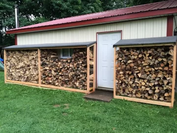

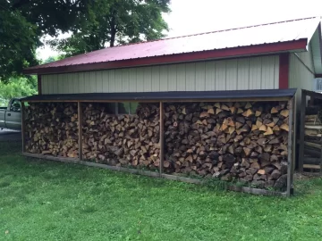

One of the nicest simple set ups I've seen,what are the dimensions,and the lumber size,what's needed to make that in 16 foot lengths,i'm going to copy cat you.I like them so much.
Yes, 10' wide, 5' tall with 2x4s. About 15-18" deep.Are those two X fours ?
Yes. ThanksLooks like a string of xmas lights across there? Neat idea.
Thanks very much,i'm going to attempt a similar set up,with 2x4x16 and will go six feet tall.Have you had any problems with stacks falling over as the wood shrinks.Yes, 10' wide, 5' tall with 2x4s. About 15-18" deep.
4.5" 5/16" lag bolts connecting top joints.
Bottom joints connected (and stabilized) with https://www.amazon.com/gp/product/B00002NBRJ/?tag=hearthamazon-20
You have to use pressure treated 2x4s for the bracket kit, as they are slightly larger than regular 2x4's.
One 2x4 in middle at top and bottom. Top raises roof in center for drainage
Roof is a 12'x2' corrugated galvanized metal roof: http://www.homedepot.com/p/Fabral-1...PIPHorizontal1_rr-_-202322817-_-202285067-_-N
Roof attached with stainless screws and washers for seal
No, but I just made them this summer.Thanks very much,i'm going to attempt a similar set up,with 2x4x16 and will go six feet tall.Have you had any problems with stacks falling over as the wood shrinks.
