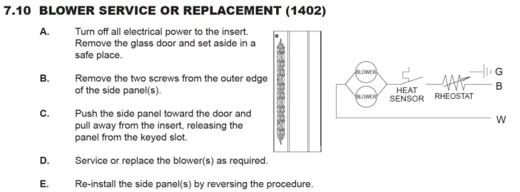

    I believe the switch is located on the right side behind the panel encasing the blower. Shouldn't need to go inside the firebox at all.

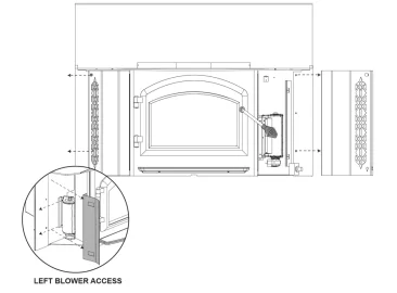

    would the switch be visible through the grating on the right side blower, or am i looking at something else- im able to tinker with things, but need visuals! bwajaja to access the thermo-switchy thing, you think i might not have to remove the bricks inside to get to the blower assembly? the manual wasnt completely clear for a nincompoop like myself! its getting silly seeing still flaming logs and temps over 400 and not having the blower working...

    I just took my the covering on the sides off last night because I herd a "pop" and the fans shut off at 500*. Turns out the switch actually burned, 2 month old stove!! Ordered a new one. If you take the cover off the side by the switch, look up in the corner behind the fan, where the back meets the fire box, should be right there on top with two wires going to it. Also, by fan wasn't even bolted to the stove, just sitting there!!!

    ive got the cover off, im currently adjusting the thermal switch thing... heres a question- should i put the switch right against the bottom of the stovetop, or leave a bit of a space? if its right against the metal, is it going to burn up right away? thoughts?

  14. theodorefalcone Member
    joined: Jan 24, 2009
    6 posts
    Downstate NY
