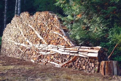

Congratulations. Take lots of pictures of the stove, hearth and the wood stacks too. We'd love to see what you are doing. Stacking is an art form and some stacks are extraordinary. Show this site to your 10 yr old for some inspiration:
http://www.alastairheseltine.com/index.htm
Wait until you start burning, that's an art too.
