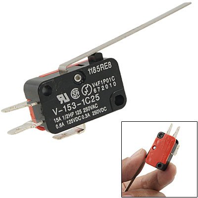

In the industrial controls world, we use something called a 'microswitch' (the name was coined way back in the dark ages when something an inch long counted as 'micro'. They're designed to be easily mounted to almost anything / anywhere, and the flexible actuator allows a fair degree of latitude in the physical contact with the actuating object.
[Hearth.com] Need a "Door was Left Open" Reminder
In the simplest case, wire one of these to a light that you would see on your way out of the basement.
For more complexity, wire one of these to a timer and an alarm.
When you go to mount it, DON"T drill and tap mounting holes in the water jacket ;-)
I'd use a low-voltage circuit - maybe a 12V wall-wart and an automotive light bulb.

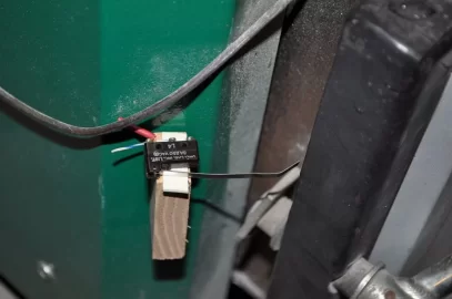

There are plenty of places that you can mount a switch that are cool enough. You could get fancy and use actuator linkages, but I'd start with something like this, mocked up with double sided tape to start, then implemented with a metal bracket. You could easily attach an adjustable rod (screw) to the edge of the door to make contact with the actuator.

Nice suggestion Nofossil!
