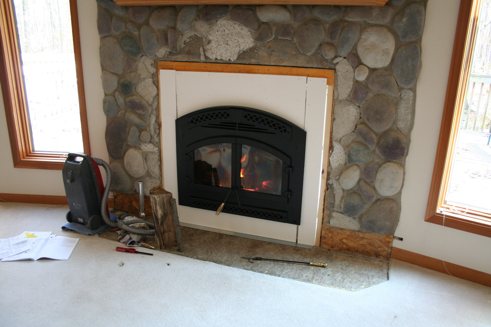

    I've got a ton of photos, and when the project is totally done I'll work on posting them somewhere on the web. For now, here's the way she looks. As you can see, I still have the mantel to do as well as some finish work.
    NOTE: The mantel is going to be non-combustible (thinking granite or polished concrete), because I chose to go lower than the clearance specified in the manual for a combustible mantel.
    -Speak

    Thanks for the info and the picture looks like you have done a really nice job with the installation . Let me know when you post all of your pictures I would love to see how the whole project evolved.

    You need the cement board. You'll need something to screw the metal lath mesh down to.
