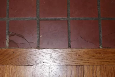

I need to replace about 9 cracked hearth tiles. A picture is shown below. The tiles are 4"x4". I live in Northern Virginia. Any suggestions about where we might be able to replacement tiles would be gratefully appreciated.

Getting an exact match online is going to be a challenge. Instead I would chisel out one of the broken tiles and bring it into some local tile shops. A good one should be able to locate a close match. You might also want to log on to the www.johnbridge.com. It's a great tile site with a forum that may be able to help you.

Another idea might be (depending on the "pattern" of busted tiles) to break out a couple more in addition to the broken, and replace with something different - a contrast - e.g. maybe a few dark (charcoal) slate tiles, same size or cut to size, random pattern? That may be a really dumb idea, or maybe a great chance to get a bit creative with a hearth update...? Just a thought...

They are not as popular as they were in the mid '50s when I guess your hearth was done.
Huh? Not getting that. You mean the tiles themselves, or the color or the size or what? What is pictured has never gone out of style. However, to the OP, as well-meaning as the suggestions heretofore have been, you're not going to find an exact match by spooking around demolished houses or Craig's List. You wouldn't find an exact match if you'd originally bought them at Lowe's and went back 6 months later to get more. Different batches, different times, etc. This, on the other hand is a great suggestion (hats off to you Bag o' Hammers):

From your posted pix the cracked tiles are all at the edge. If the unseen ones are likewise, you could re-do the entire border. I'm partial to blue.
I had those tiles on my hearth and a few of them cracked as well as the mortar joints. They are commonly referred to as red quarry tile. I had a very hard time taking them out and broke almost every one with a sledgehammer to remove them. I also rebuilt the subfloor as time caused the wood to shrink and dry out causing deflection issues. Stand on the tiles and see if there is any movement, if so they will probably crack again. I hope it does not turn out to be a major tear out job for you. Good luck.
