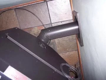

Mine is pretty simple. Stove adapter,45, and a 2 foot section to go thru wall thimble.

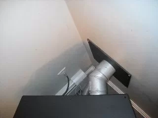

here's mine. 3" simpson duravent pellet vent pro. good quality pipe

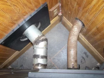

this is my set up 3 inch duravent, stove adapter, 45 angle, and 3 foot pice going threw the wall. my frest ait intake is a pice of 2and 1/4 flex automotive exhaust pipe ($5.00).

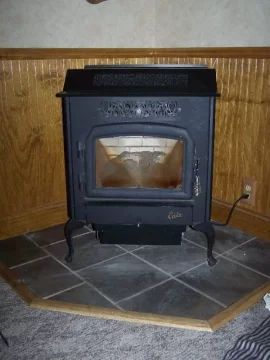

Here's mine, pretty simple, stove adapter to 45 elbow to straight pipe.
Mike -

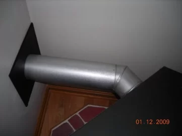

My 45 elbow is actually a 90 that I was able to swivel enough to make a 45. I plan on replacing it with an actual 45 if it will work with my stove placement. Piping is Simpson Duravent rated for corn, older style with the rope gaskets.
