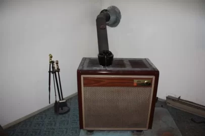

I moved into my house last year and this has been the first winter. When getting my insurance setup they informed me the woodstove is not to code many different ways after an inspection. It was a nice surprise that none of the other inspections ever brought them up when I was purchasing. I have included some pictures...
The many code violations include
- Improper base/floor protection (the thin painted board isn't enough of course)
- Corners of woodburner closer than 36" (currently about 28")
- Improper connection to chimney (not a clay tile thimble)

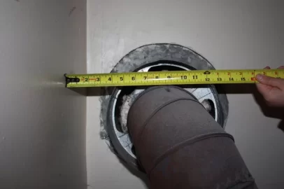

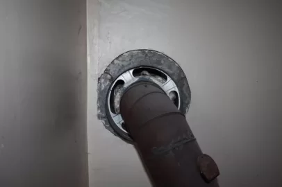

I was reading through the code book and have concerns if the current setup can be brought up to code at all. In one picture you can see the homemade metal thimble that goes into a brick chimney located on the outside of the house. The connector is somewhere between 5 and 5-1/2 inches from the drywall and reading through NAMIC code and my understanding is that 6" is the minimum with some wall protection. Would there be a way to fix to to code? I'm assuming anything that may bring this up to code would be some type of wall protection that would eliminate the distance the burner is to the walls.
The feet of the woodburner are over 2" so the documentation says it requires 4" hollow masonry laid to provide air circulation through the layer and covered with a 24 gauge of sheet metal. If there any good ways to do this what would look good? Does it have to be metal? or could it be covered with masonry of some sort? and do the hollow cavities need to be laid horizontal? and seen from the front?
