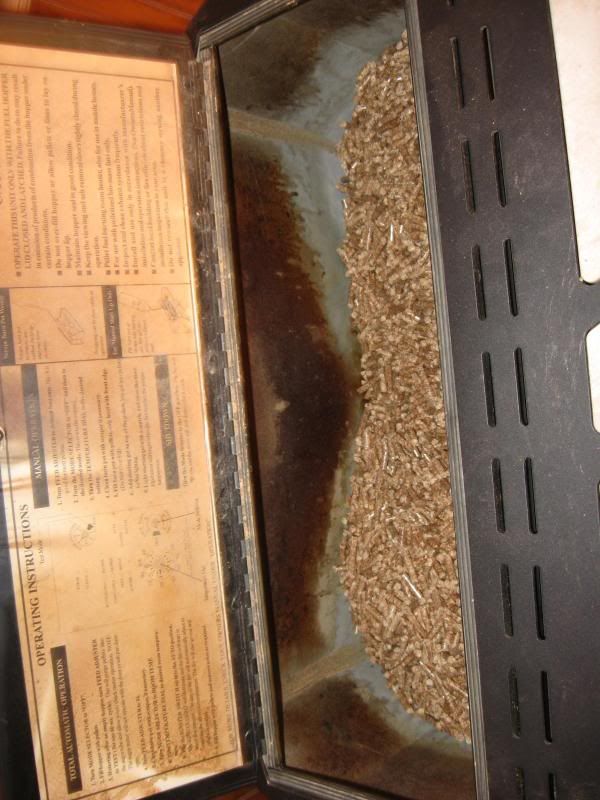

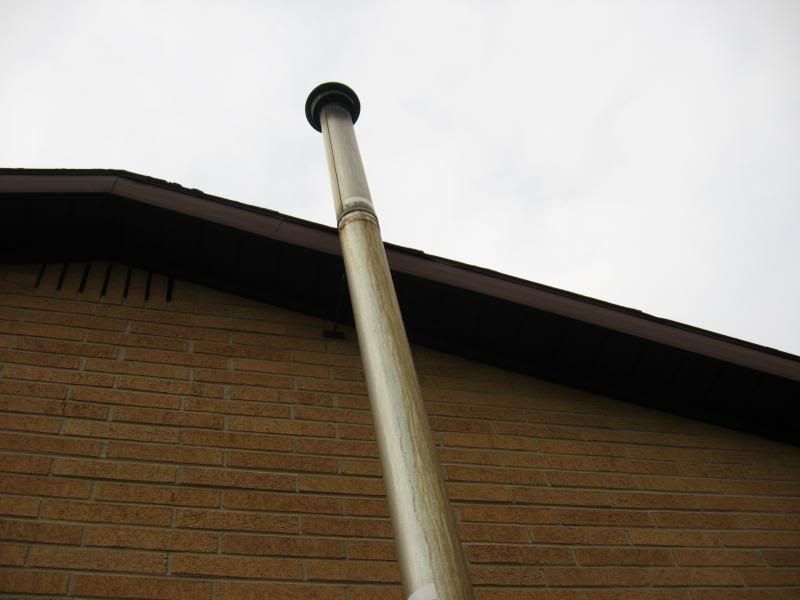

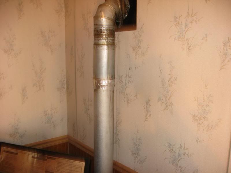

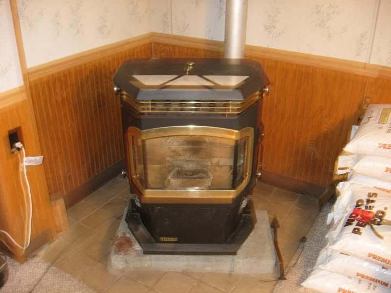

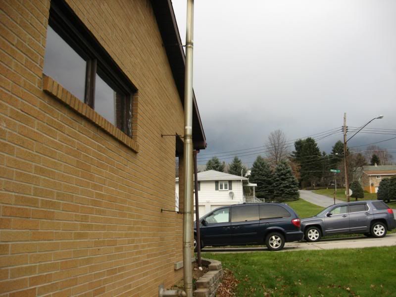

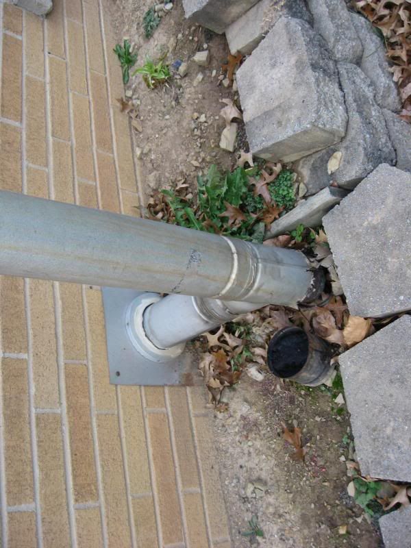

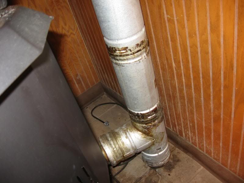

    Okay went and took a few pictures, didn't get as many as i would have liked, a few of the pipe outside and inside the house it looks to be 4" the stove for being 13 years old looks clean it looks to have had fire back through or into the hopper area they told him that the exhaust pipe had gotten very hot and was on fire at different times. They told him the whole stove needs dismantled and cleaned 2 people at 60.00 per hour about 4 hours or so to do. It needs an ignitor and new gasket on the door, and new pipe inside and out, may need the vacuum switch but needs tested first and possible a new board as the feed rate knob is loose and it doesn't seem to stop where it should, I could pull it right out and put it back in, not sure what is wrong there with out seeing the back of the board to find out how that works.
    He has been lighting it with the propane torch, the ignitor must have been out for a while, the fire from what the dealer told them is not coming out into the fire box enough and seems to be burning back into the auger tube, this would make me question the integrity of the hopper lid seal maybe.
    He is going to home depot to look for pipe tomorrow and i offered to help him take the stove apart and clean it if that is what it needs, they would just leave the dealer do it but they they don't have the cash to go that route right now.
    Any ideas or pointers on things to look for and check is greatly appreciated.
    thank you

    That stove does have some major issues. It has had a hopper fire/ smoke in the hopper. This gums up the feeder assembly. The stove needs the updated feeder which is a major repair. Harman has been warrantying this repair even on older stoves.

    Man that baby is in rough shape....all of what is needed is very doable. If it were me I would tear it down and give it a good going over. The venting looks very suspicious and at the very least should be disassembled and inspected. You don't need all that piping up to the roof. The auger is chain drive and a quick look in the rear after removing the side panel will tell you if the chain is on or not. If you are handy at all, you can get this cleaned up and running. You aren't gonna do it on the cheap and you won't have it running tomorrow....
