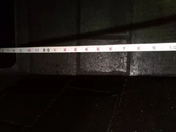

    So up on the roof today again to get some measurements, and here's what I came up with. It's ~19' 8" from the top of the chimney to the damper plate, and probably another foot is needed to reach the outlet of the stove. Think it's better to go with a 25' liner to make sure I have enough to reach the outlet or just get a 20' and go with a small section of rigid or adapter down on the stove side? I know the appliance adapter will give me another 6" or so and that might just be enough to make a 20' work, but adding another 5' of flex liner wouldn't be the end of the world either they're just more expensive depending on the brand. (Some are $50 more, others are $120 more for the extra 5')

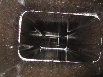

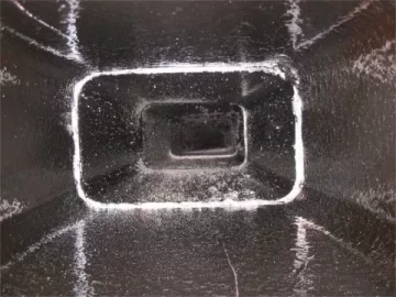

    All sounds good. After you get that glaze out of that flue. A hot liner is gonna set that stuff off. And at that point it will be contained in a closed space between the block off plate and the top plate.
    Don't think I know what I am talking about? This was my flue before I set it off.

    Yup! Should have mentioned that I know those tiles are nicely glazed and need a cleaning... The entire chimney will get brushed and sprayed from top to bottom before the liner goes in. Those pictures are from a week ago and I have run some creosote remover through the stove to make that stuff a little more manageable.
    For what it's worth, the smoke chamber and such are pretty well cleaned, I had done them right after I took that shot of the flue. Knew I would be taking it all apart to clean again, so I didn't scrub the flue tiles at that time.
