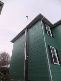

So here is a pic of my new install and one where you can see old install - old install was terra cota and with cement block. Was old and used with coal and gas stoves. I used in for this season when I got my new stove - no issues just wanted to have something safer since the block was starting to rot out.
When I fired up the stove noticed a huge difference in what my stack temps went to and how hot it now gets with the cat engaged. I will have to now make sure it doesnt get running away with temps.
Also will be able to clean from the bottom as it has a clean out vent. The chimney is also shorter as it lost the bottom section even though they made it a little higher at the top
I didnt think it was going to make this big a difference
